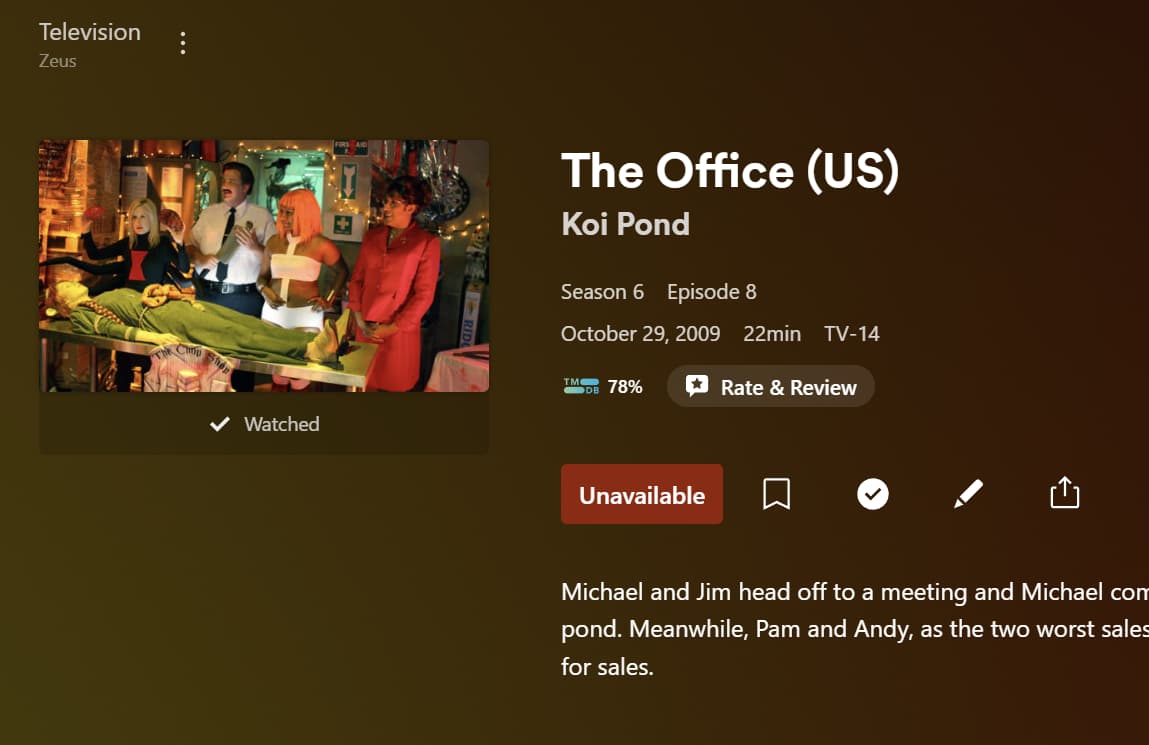

TV Episode shows hundreds of files that do not exist. Cannot remove them
Server Version#: 1.43.0.10162 (Unraid)
Player Version#: N/A
I have this episode of The Office which shows hundreds of duplicated files. I am unable to delete them from plex, they do not exist on disk. I have tried removing the episode entirely but still shows there as “Unavailable”. Replaced it with a new copy, still shows hundreds of the old ones “unavailable”.
How can I clean this up?

Completely removed the episode, scanned, emptied trash, etc. Episode still shows in the list as “unavailable”.
Try DBRepair.
Here’s an example: GUI based database corruption identification/repair - #2 by FordGuy61
is /television empty?
This did not fix the issue. Shrunk my DB a little though.
No, I literally have tens of thousands of episodes.
Solved! I don’t know if it took a while for the menu system to catch up with the DBRepair, but I went back a couple hours later and the item was all sorted out.
