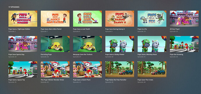

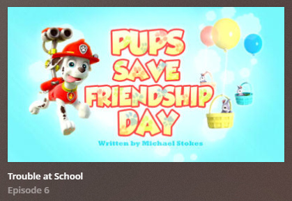

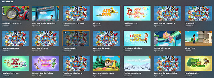

I have 75 episodes of Paw Patrol, spanned over 3 different seasons and for some reason 4 out of 12 newly added episodes are incorrectly identifying as a completely different TV show. There isn’t even commonality between the episode or show name. I have followed this process from another thread:

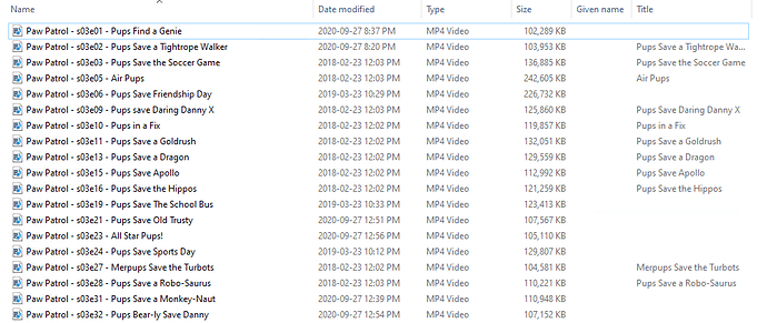

What are the names and structure please, exactly as you have them, including extension.
Episodes I added today have today’s timestamp. Episode 1, 6, 21, 32 are the ones that are not working
For those episodes it didn’t add, please check the internal media info.
Pay particular attention to to given name/title field.
If it doesn’t reflect the actual title or is otherwise ambiguous (full of junk ) then that’s the most likely (and common) reason. PMS reads that info from MP4 / M4V files and will use it in favor of the file name.
Since your names are perfect, I would recommend clearing any internal metadata title / name values.
Once cleared, move those episodes out, scan files, empty trash, clean bundles then move back and scan again.

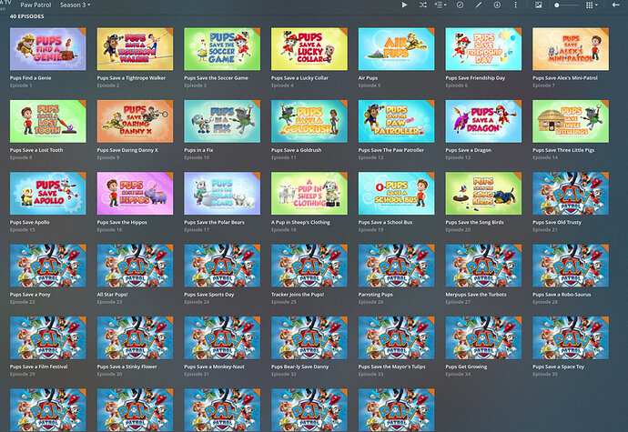

I set my media aside and created a 280 episode block (7 seasons x 40 episodes / season)
I am getting all the metadata and correct matches but finding missing artwork at TheTVDB.
