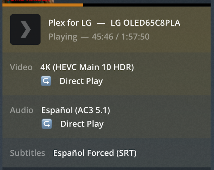

I have some 4K files (HEVC Main 10 HDR) When they start playing on my TV I see the HDR notification on top-right corner. Every seems to go well but after a few minutes the video pauses and when the image comes back it has HDR disabled (colors are less saturated). Looks just like when you open an HDR file on a non-HDR screen.

Doing direct play on video and audio
for any number of reasons, the stream is switching from direct play to transcoding down to 1080 (thus loosing both 4k and HDR).
the logs indicate that you do not have hardware assisted transcoding, so that causes your cpu to convert the 4k, and which is extremely process intensive and your server cannot keep up.
most smart tvs cannot direct play HD audio which is the typical culprit.
subtitles also can cause problems and make plex transcode.
you can make sure subtitles are disabled, and choose a different audio stream (ie dolby digital/dtx 5.1).

Thanks for your reply! From what I can see here the TV is able to play both video and audio directly.
Not entirely sure why it’s changing to direct to transcoding but I should have plenty of power in the server (20 cores and 40 threads available).

Alright so I’ve tried disabling the subtitles and it seems to be working fine now.
However I’m unable to disable the subtitles on Plex for LG system-wide. I have to disable the subtitle every time I get into a new movie/show.

I have to say that in the scene there wasn’t any subtitles showing up, but I guess the fact that these were enable is enough to trigger this. However why is transcoding at 1080 without HDR instead of 4K with HDR if I have plenty of power to do so :thinking:
plex does not transcode TO 4k, and it does not transcode into x265
so the only option to transcode into is 1080 or less.
nor does it do any color conversion, which is why you lose the hdr.
ahhh damn! thought it was just a matter of selection resolution and features (HDR, etc). Thanks so much for your help!
