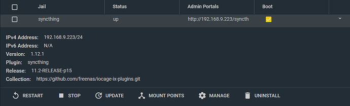

Plugins would normally be updated from the “Update” button you get when you click the arrow on the right to expand the entry on the plugins screen like here:
