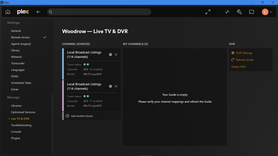

Found that I couldn’t record more than 2 programs at the same time. Hardware check good, 2 x 2 tuners are shown & they will fill up the channel lineup. It seems that there is no EPG data and when I tell to refresh, the activity indicator is done in 3 seconds like there is nothing available.
I removed then re-added the tuners, now none will get any EPG data. They both still find all the channels available.

Screenshot attached:

OK, better now. I renamed a bu db from 4-18 & the guide is working again. I must have caused the issue while trying to investigate my original problem, which unfortunately is still present.
PMS refuses to use all 4 tuners simultaneously. I record the late night shows, Kimmel, Colbert, Fallon & Meyers. Recently 2 of those 4 shows stopped recording. Plex Scheduled Recordings listing indicates conflicting recordings & allowing only 2 to record. All 4 tuners indicate with the green dot as shown above.
Now that the issue is back to unavailable tuners, I’m re-titling this thread.
Problem solved.
I had to use the PMS settings to Delete DVR completely & setup from scratch. Not too bad a process. Fully functional again but I had to recreate all my scheduled recordings.
Re-doing the tuners separately multiple times never worked out & probably caused my Guide issue by downloading it a dozen or so times.
