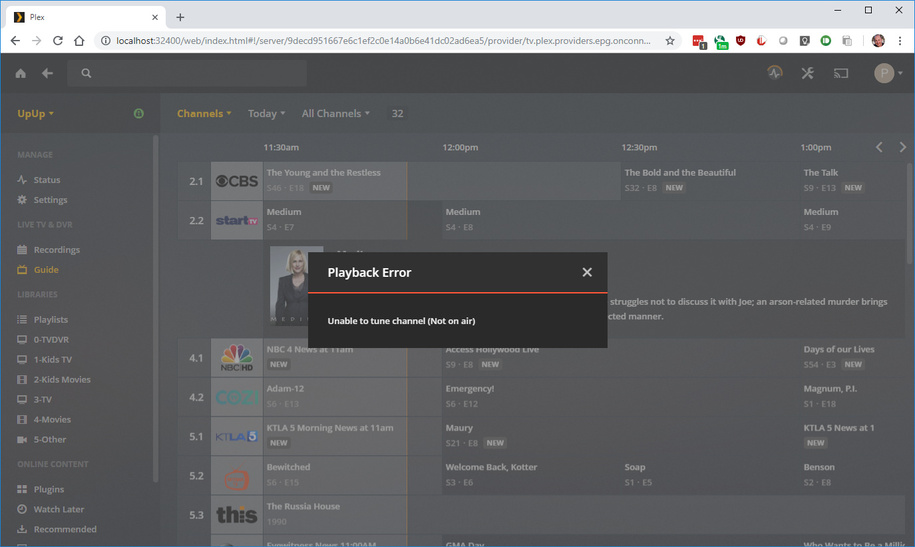

I have two servers set up at different locations. One of the locations, is hooked up to a SiliconDust tuner for DVR features. However, when I use my other location (the one without the live TV), it still shows a guide as if the feature were enabled. Of course, if I try and tune to one of the channels, I get “failed to tune” (or something similar).

Here’s the screengrab of what I get on the REMOTE server via the web interface
If there’s a specific logfile I can provide, would you let me know its location?
The log would be from PMS. Settings \ Server \ Help \ Download Logs. It’s a zip file, so just upload the entire file.
