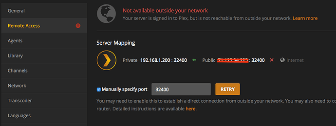

Remote Access under the Server settings fails. Not sure why if nothing changed on my network.

Also the Remote Access shows Red Status above in the screen shot

The Red Status as mentioned before is because it seems port forwarding is not working. Not sure why not when it was always working before.
see the screenshots
