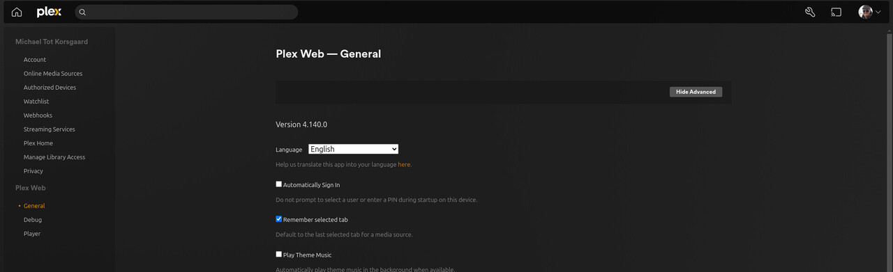

I have installed my first Plex Media Server and after a few attempts managed to claim it. But when I try to follow this guide https://support.plex.tv/articles/200288926-creating-libraries/ unfortunately I end up at a blind end fairly quickly, as there is no media server to select in my settings, nor any of the menu points from the guide. Making me think that I am not accessing the right app. I hope that there are someone who can guide me in the right direction.

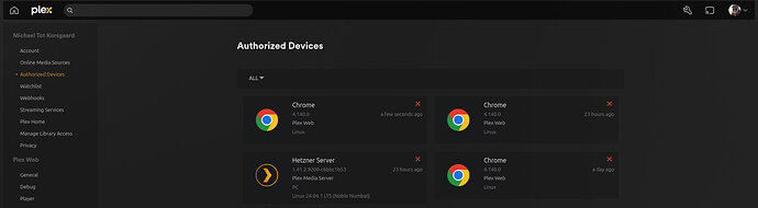

If you click on “authorized Devices” on the left side, do you server listed?

What concerns me is there is no server showing on the left side. It should be showing up right below the Plex Web section. This is suggesting to me that you server claim didn’t work.

I do see my server (Hetzner Server is the name).
