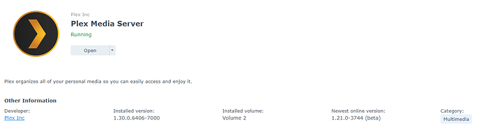

I’ve tried and it does not open
Show me a screenshot of what you see please ?
thanks I was able to use the page http://ip.addr.of.syno:32400/web and it work but now my remote access remain disable
