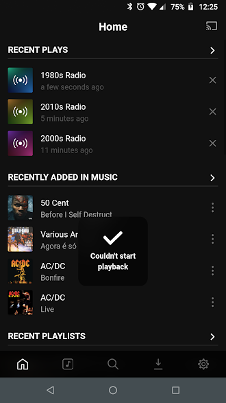

I’d like to report that I’m (maybe we) still unable to play most of the library radios. For some odd reason, the only one that I don’t have trouble with is “Randon Album Radio”. That one plays ok.
I enabled debug and trace logs but, nothing is said on the server-side, so I’m attaching my cellphone logs and a screenshot of the error I’m getting:

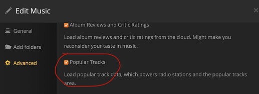

The likeliest reason for this is that you’ve disabled popularity here:
Yes, I didn’t have this option checked. I enabled it, scanned my library a couple of times, and waited for about 12 hours, just in case some background task had to be done, but still, no progress.
Here are the new logs:
Plex Media Server Logs_2021-01-22_09-10-17.zip (859.1 KB)
Scanning won’t help. Refresh Metadata is needed.
That did the trick!
I thought Load popular track data, which powers radio stations and the popular tracks area was related to popular tracks at the current year, which I have no interest.
Enabling that option and doing a full metadata refresh got all the Radios working.
