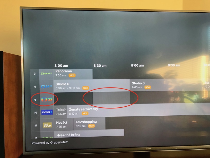

I have exact same problem for czech TV (see image). Is any way how to fix it?

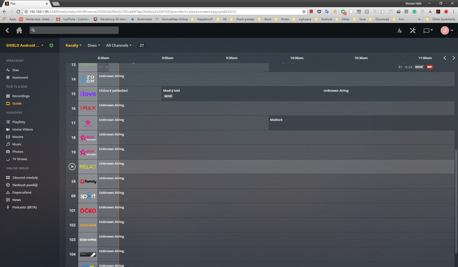

I have the same problem on v1.13.5.5291 (beta) but it’s missing epg data from HDHomerun with “unknown airing”. I checked the Homerun EPG API and the shows are there during the “unknown airing” times.

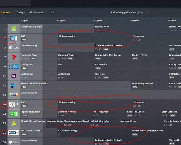

its actually the same program, las minute change from the network, as you can see, cant record on ANY of the channels! its on.. its all the same program… id say its a bug in plex that cannot handle last minute updates…
