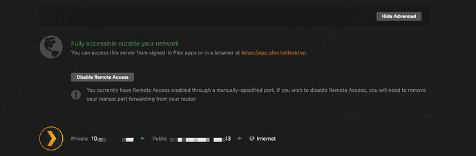

Have you confirmed that remote access is working? Having the pass does not magically make remote access work.

Checked my router config, have uptime monitors logging interruptions, and yet it would persist, until now for weeks i haven’t had access to my library remotely. VPN works fine, but that doesnt address your question, as it puts me effectively on my own LAN.

If the server shows as unavailable when you’re trying to access it remotely, but then works fine then you use a VPN it sounds like an issue with your setup. Most likely the port forwarding is set up incorrectly.
My suggestion would be to restart PMS, let it sit for 3 minutes without any activities, then try accessing it from a device that you know can’t connect. Grab logs from both the device and PMS and provide them here so i can review them. 1 of the 2 logs should indicate the problem.
Must be annoying, just checking can you stream remotely using a non iOS client (browser, macOS etc). Just to clear up if this is an issue with remote access or just something odd in the New Experience.
If you are able to login to the web console, then check settings and see if remote access is showing as setup and working.
