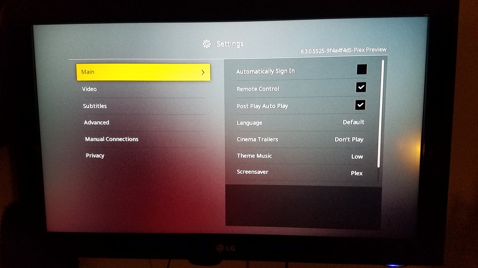

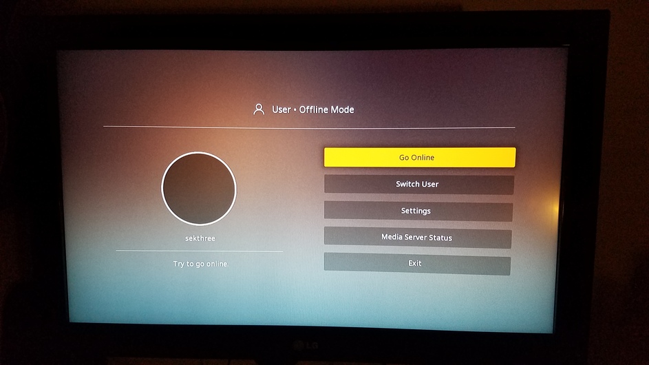

I was confirming in another thread that Plex can still be accessed when there is no internet, when i stumbled upon that Uno does not connect, despite 6.1 version of the release does.

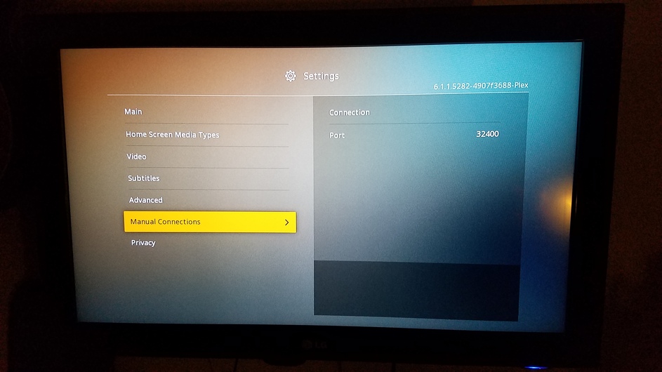

When i try the 6.1 version of the app it works fine:
I also noticed the settings are shared between Uno and 6.1.. when i changed a setting in one the other also got updated. like adding or removing the manual IP. Version 6.1 worked both with and without a manual IP.

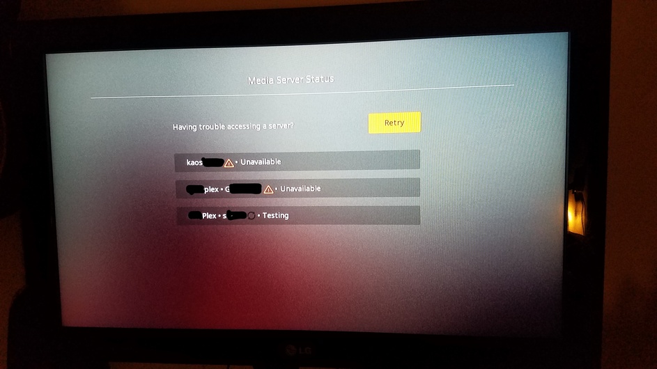

Under the advanced tab there is a setting to allow insecure connections. Try enabling that.
it’s set to “On Same Network”.
Maybe the Roku isn’t able to identify the network properly. Try setting it to always. If that works, then there is an issue with the app knowing it’s on the same network. Provide me the log from the app so we can check.
@ljunkie is working improving handling for various offline scenarios. Hopefully that will fix this issue.
