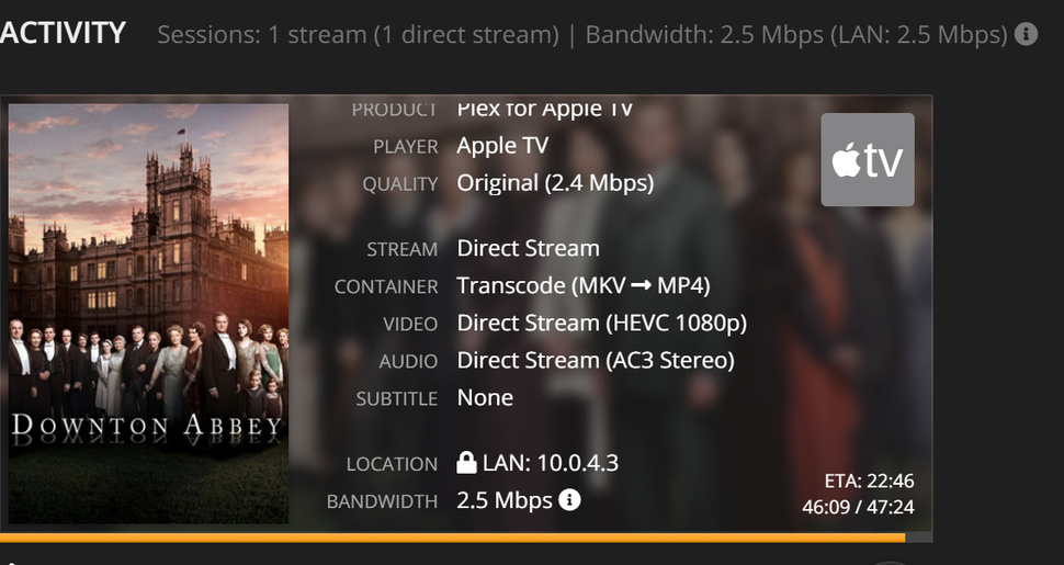

look into running tautulli if you want to see exactly what is being changed when transcoding. It is helpful in troubleshooting.
compared to native plex
