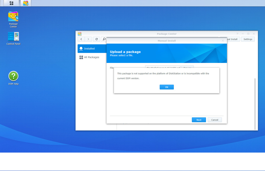

I have a Synology DS216Play running DSM 6.2.1-23824 Update 6 and when I try a manual install with the file:
PlexMediaServer-1.15.1.791-8bec0f76c-armv7hf.spk
it gives an alert that says:
“this package is not supported on the platform of Diskstation or Incompatible with the current DSM version”
Any ideas?
Thanks.
Thanks for this. How do you know which one is for my NAS? It offers 2x ARMv7 ones and a load of others too.
Awsome thanks

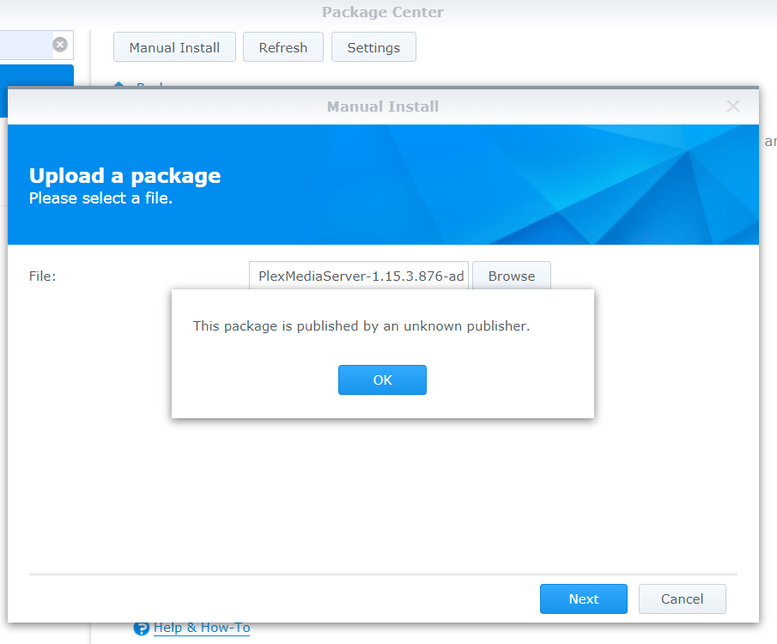

I am having the issue when trying to manually install the 1.15 version i get package is published by an unknown publisher but no longer gives me the option of hitting the install anyway “yes” button.
