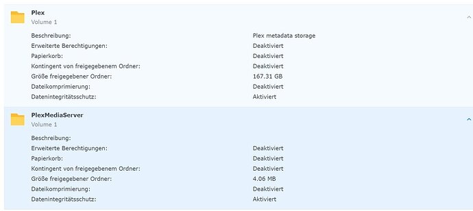

  1. What is the shared folder name
  2. What are the permissions on the “Plex” share ?

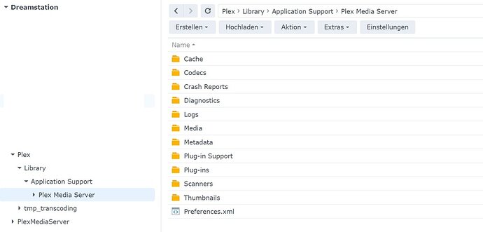

From my POV, everyhing as it should be
Contant of Plex folder:

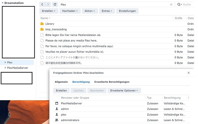

Did you give PlexMediaServer permission to access the Plex shared folder ?
Yes see picture 1. PlexMediaServer has full control for Plex share.
@braun.th
If it now has Full Control, for all Sub-folders and files
  1. Uninstall Plex - ERASE option to remove the empty DSM 7 setup
  2. Reinstall the package
  3. The installer will automatically engage
Do not interrupt the installer once started.
You may open a new session to DSM and look at Migration.log (after about 3 minutes) in the Plex shared folder to track progress.
