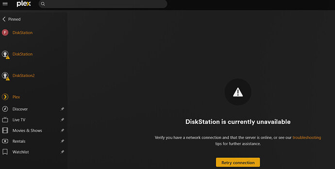

Upgraded from DSM 6.2.4 to 7.1.1, Latest Plex Server, now servers are inaccessable
Server Version#: 1.41.7.9823
Player Version#: 4.146.0
As subject stated, Upgraded my Synology DS414 from DSM 6.2.4 up to the latest DSM 7.1.1. Used the correct Plex server software for the processor in the NAS, and everything seemed to go along perfectly until I tried to access my media. It’s not accessible. Followed the instructions to give my account (the account with the stored media) read/write access to the PlexMediaServer account, but no luck there either.
I have 2 NAS devices where content is stored, uncleverly names Diskstation and Diskstation2. Neither of these show as available, “DiskStation is currently unavailable, Verify you have a network connection and that the server is online, or see our tips for further assistance.” Same message for both. Plex Server is running on the unit called Diskstation.
One thing that might be a clue here is that there is now a NEW server called Diskstation that shows as online, but there is NO content, none of my previous settings are correct, etc. It is as if it’s a brand new install instead of just updating the original installation.
I tried searching the forums, found a few things that didn’t help. I fully uninstalled the Plex server installing, Uninstall only (save all files), rebooted the NAS, then reinstalled. Nothing changed.
Need help getting my Diskstations back online properly, hopefully without having to start from scratch!

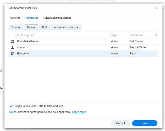

Following through on all the settings for Scenario 2, I went through and set all the permissions as they are supposed to be for the PlexMediaServer shared folder, including making sure that I check the box for “Apply to this folder, subfolders…” clicked save. It took a LONG time, but came back up and has the permission designated as “Full Control”. I saved that out again, then uninstalled the current install of Plex Server as instructed. Since it did show as installed, I followed the step in Stage 2, Line 1a and selected to Remove everything instead of just uninstalling.
Trying to reinstall Plex now, and I keep getting the error that the shared folder does not have the necessary permissions. I even rebooted the NAS thinking that maybe with the permission’s changes that it needed to be rebooted. I went back in to the permissions for that folder and verified that everything was set correctly, applied all the same permissions again (went very fast) and attempted the install a second time. Still no go. I’m at an impass right now, unable to install Plex Sever due to the preinstallation checks failing.

You’ve made a grave error here — WRONG Shared Folder
You used: PlexMediaServer – This is incorrect.
You want this one: Plex shared folder (where your server’s data is)
We are going to move from the Plex shared folder → PlexMediaServer shared folder. The DSM 7 app already has R/W access
In DSM 7,
  1. We can’t use the Plex shared folder anymore
  2. We can’t use user Plex anymore.
  3. We lost all privileges to do this automatically for you (why you need to do it)
At this point.
  1. Confirm you have given System Internal User PlexMediaServer Fulll Control of the PLEX shared folder and Applied to this folder, sub-folders and files
  2. Uninstall the DSM 7 app
  3. Delete the PlexMediaServer shared folder. (it will be recreated with correct permissions)

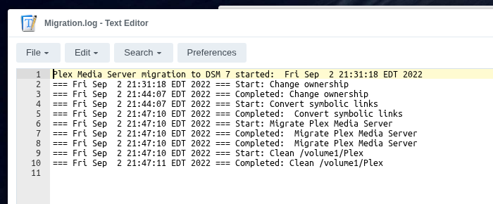

** After about 3 minutes, in the Plex shared folder,
** You will see Migration.log
** This is how I let you know what’s happening.
This is what you’ll see.
As you can see, the most time consuming part is making certain permissions are as they need be. (the first step)
When all processing is complete,
  1. Plex shared folder should be empty. ( I remove `Library / Application Support / Plex Media Server )
  2. Anything you’ve placed in the Plex shared folder will remain.
  3. The Server will now live in the PlexMediaServer shared folder
  4. Due to how restrictive DSM 7 is, Please DO NOT put anything in the PlexMediaServer shared folder.
    – I made it visible so you can make backups and get logs if needed.

For Reference, my migration log is as below:
Plex Media Server migration to DSM 7 started: Wed Aug 6 17:14:51 IST 2025
=== Wed Aug 6 17:14:51 IST 2025 === Start: Change ownership
chown: cannot dereference ‘/volume1/Plex/Library/Application Support/Plex Media Server/Cache/va-dri-linux-x86_64/iHD_drv_video.so’: No such file or directory
=== Wed Aug 6 17:15:30 IST 2025 === Completed: Change ownership
=== Wed Aug 6 17:15:30 IST 2025 === Start: Convert symbolic links
=== Wed Aug 6 17:16:18 IST 2025 === Completed: Convert symbolic links
=== Wed Aug 6 17:16:18 IST 2025 === Start: Migrate Plex Media Server
=== Wed Aug 6 17:18:41 IST 2025 === Completed: Migrate Plex Media Server
=== Wed Aug 6 17:18:41 IST 2025 === Start: Clean /volume1/Plex
=== Wed Aug 6 17:18:47 IST 2025 === Completed: Clean /volume1/Plex
