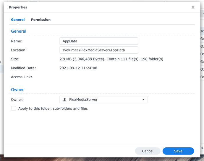

Thanks! This did work, partially.
I was able to get the server back online, and accessible from all my devices.
But my library is completely lost as shown below.
On the sidebar, the old server is still listed, with all my libraries inaccessible with the “!” icon.

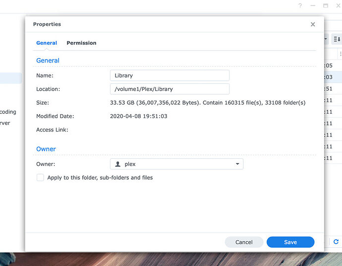

One thing that doesn’t feel right is that the new “PlexMediaServer” folder is quite small - only a few megabytes, as opposed to the old “Plex” folder that is 33GB in size.
Is this normal, or has migration failed and need to remigrate the metadata somehow?
One question before I get started: the option “Erase all of Plex Media Server from this system” says it’s “Not Recoverable”, and the description on the post says "No libraries or preferences will be retained."
What it says is a bit alarming. Does this mean at this point, there is no option except starting from scratch, and my customized library and metadata are lost forever?

If you still have all your metadata in the Plex shared folder ----
  1. Everything you had in DSM 6 is safe.
  2. Only the errant fragments of DSM 7 are erased.
What Uninstall + ERASE does is, by removing the bad DSM 7 install/data, it clears the way for your DSM 6 data to be properly moved over.
In this case, to clear the bad DSM 7 data (which is very small) – YES, you want to erase it.
Thank you @trumpy81 and @ChuckPa for the easy to understand and right-on-the-target solution!
Following them I was able to get Plex running just as it was in DSM 6 with all my files and metadata intact.
