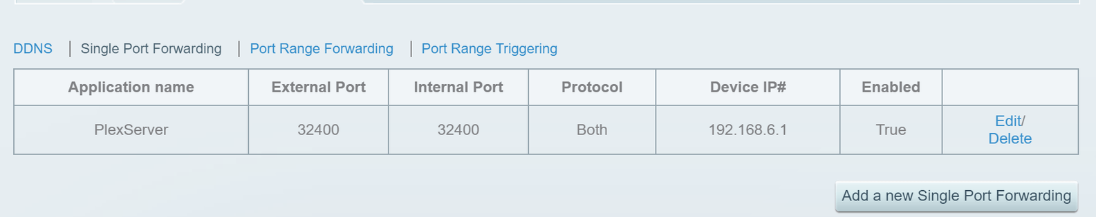

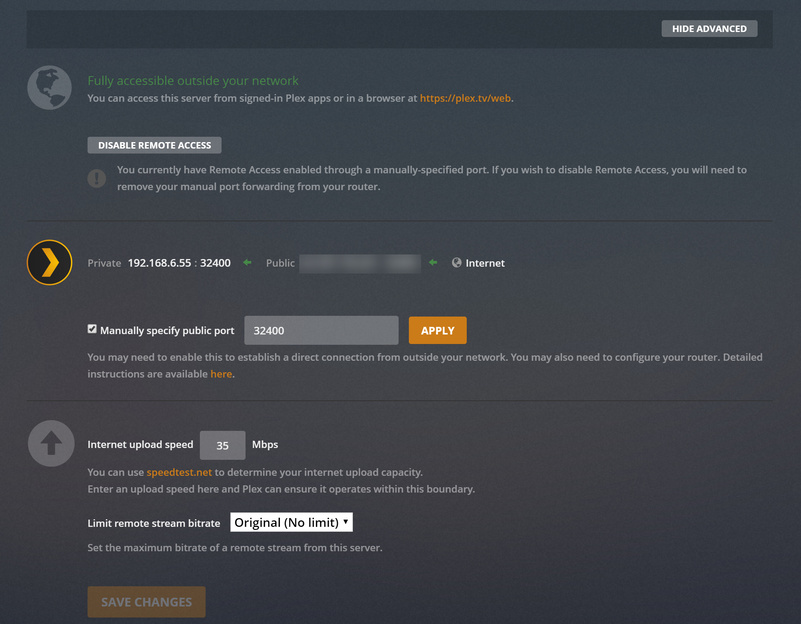

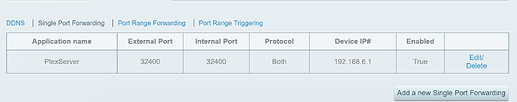

After running into this problem and looking through this thread I was able to get things working on my end by setting things up like this:
- I have my Cable Modem and Primary Google AP plugged into my router.
- I have an extra switch which I then plugged into the Primary Google AP
- All my other devices were then connected into the switch, including the Plex Server.
- In the google WiFi app
- I changed my Router LAN Address to 192.168.6.1
- I reserved my Plex Server’s IP address 192.168.6.55
- I then port forwarded port 32400 to my Plex Server
- On my router:
- Not sure if this is necessary, but on my router I modified my subnet mask as shown here and limited the max number of users so that it would account for the IP’s on the Google network. In the networking section of Google WiFi app this will report that there is an overlap in IP address space with the WAN (router).
- I then port forwarded port 32400 to the Primary Google AP’s IP Address.
- The end result was that my Plex Server is now accessible externally:
- Plex Server showing status
- From iPhone, not connected to the home WiFi network.
