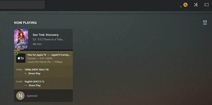

I’ve been having recent issues with my plex environment. When playing content using the Plex App and the new video player, playback is choppy and the plex server shows high cpu utilization. However, when using infuse and the old player in the plex app, video playblack is smooth and cpu utilization is low.

That Dashboard/Activity screenshot shows ST:D playing Directly, so it shouldn’t be transcoding or even remuxing or causing high server CPU usage.
Just to confirm - those screenshots all go together?

The images were taken at the same time. Playback stutters when the CPU spikes. So the mac is connected to 2 networks. 192.168.25.x is the main network and 192.168.50.x is the network for the lutron system. I have no clue where the 169.254.x.x address is coming from :-(.
