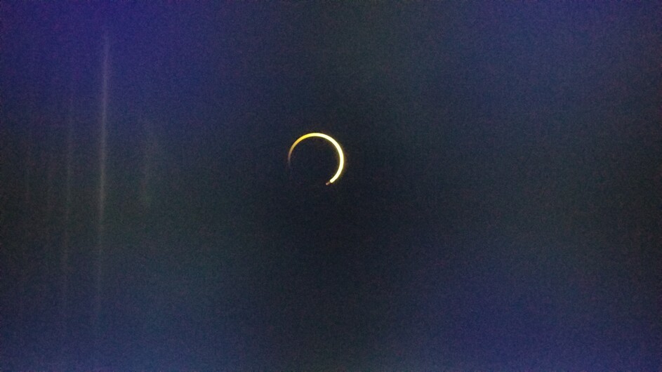

After the following three changes, my Vizio TV app no longer loads, presumably searching for the server and not able to find it. When I launch the app I get an eternal spinner. I don’t know which update broke it, but the web client from other computers and the Roku work fine.

The spinner is the next thing to display after launching the app.

Do you mean immediately you have a spinner? That sounds like the TV spinner before the app even loads (the app doesn’t have a spinner while it’s loading). What is your TV model?

Yes, immediately the spinner. So, then what is keeping the app from loading?

I can’t say exactly when but Plex stopped launching on my Vizio M65-C1 (within the last month or two). It continues to work perfectly on all other devices on my home network, some devices being 10 years older than the Vizio. When I launch the Plex app, the screen displays a spinning white circle on a black screen. All other apps work, including Netflix. I’m using the latest Plex server on the latest Win10 OS on a really great home computer I built. Without going into all that exhaustive detail, I’m convinced that the Plex player software on the Vizio has become incompatible with the M65-C1. I’ve reset the Vizio to factory settings and reloaded Plex, with no change in result. I get about 40MB/s wifi connection, so doing a direct connection won’t probably change anything. I would just like to know if my TV is no longer compatible, or if Plex will make a change and it will soon become compatible, or if I need to maybe use a compatible stick. I appreciate the Vizio is 5 years old but it’s hard to take that my very excellent 4K Smart TV with still the latest wi-fi hardware is no longer compatible with one of the most popular home network streaming applications. Thanks for any factual information.

When I started the Vizio Plex app, it started but reported it couldn’t connect to the previously configured Plex server. The retry and home buttons did nothing. If I exited the app, next time I tried to run the Vizio Plex app, I got the Vizio OS spinning wheel (trying to start app) indefinitely.
Powering cycling the TV made no difference. The only way to stop the infinite spinning wheel (from Vizio OS) when trying to run Plex app was a factory reset of the TV
I removed the Vizio device from the plex server, factory reset the TV. Was prompted to reconnect (plex.tv/link). Same situation as above re-occurred.

My server was down so the Vizio app legitimately displayed the error screen. I restarted the server but selecting retry on the app error screen did nothing and selecting “home” just endlessly displayed the Plex “…” ptogress indicator.
At this point the app had seeminghly corrupted its internal storage as trying to run it again (after power cycling the TV) permentently displays the Vizio OS spinning icon indicating an app is loading (which normally displays for only 1 second) but the app never starts. All other apps still start normally.
At this point the only option is to factory reset the TV and relink.
