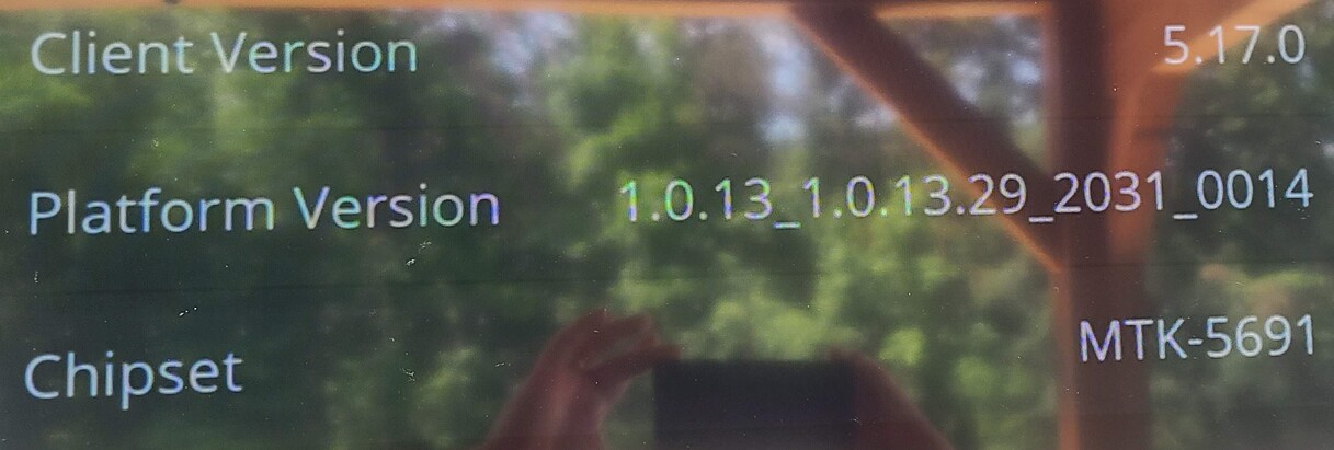

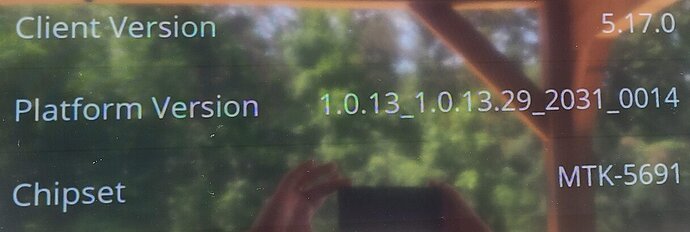

I have 2 of these TV’s and they are identical, bought on the same day. The other one works fine, but it is not at the same software/firmware version.
This is the info on the client/TV that does NOT work:
This is the info on the client/TV that does work:
So…clearly, the one that does work has not been updated.

Sure thing. I just did a factory reset on the TV that is not working and went through the setup process again and once done…it still does the same thing. The firmware version is newer on the TV that does not work. Plex did update to client 5.17.0, platform and chipset remain the same as the 1st pic I posted. So the platform of the client is different on the working/non-working TV.
