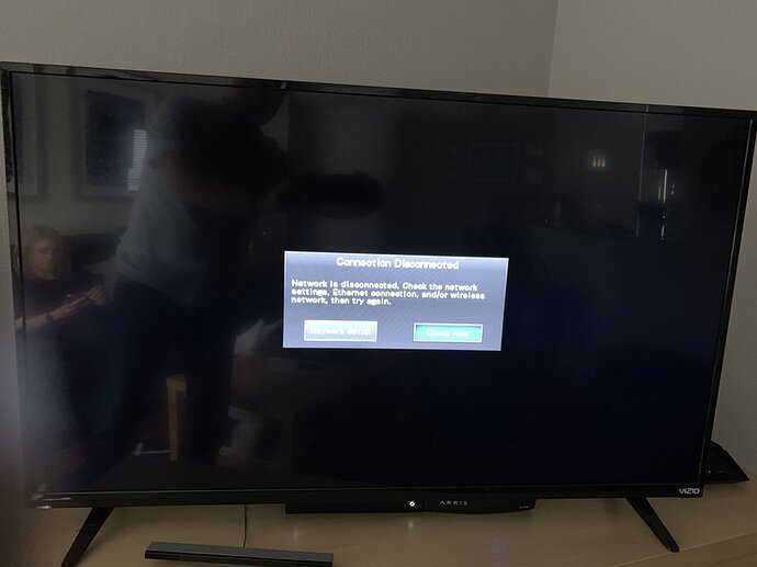

My Vizio is still disconnecting as soon as I enter the security pin. I’ve switched accounts to see if that would change anything but it does not. The image attached is what I see a few seconds after I enter my pin.
Any suggestions?

Have you tried uninstalling and reinstalling the Plex app?
Which model Vizio TV are you using?
Yes. I used the App Store on the TV to remove Plex and re-add it.
It is a VIZIO model E43-C2.
Thank you for helping!
When you uninstalled did it prompt you to login again? If not the next step would be to do a factory restore/reset of the TV to ensure all stored data is purged.
Also take a look at your server and ensure secure connections are not required as that could be causing issues.
