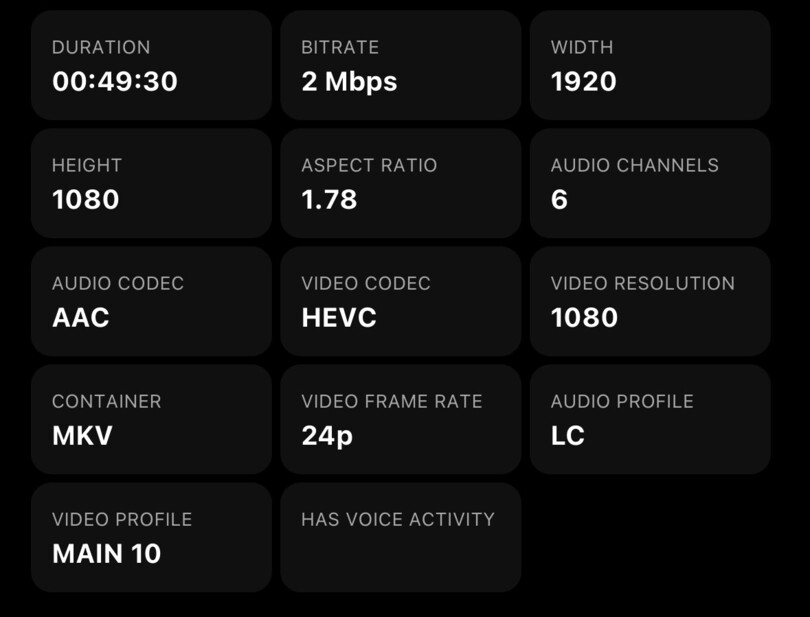

My subtitles aren’t auto-syncing. It used to work a long time ago, but now it’s not. Doing “Analyze” on any episode/movie finishes very quickly (under a second) and voice analysis doesn’t seem to work. All players have “Auto Sync Subtitles” checkbox grayed out.

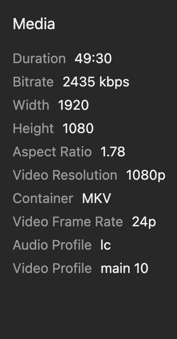

If I go to “More Info” on any item that’ supposed to have it on, the “Has Voice Activity” field that’s supposed to be at the bottom is not there:
Plex Dash shows it but as a blank box:
I have the “Generate voice activity” setting enabled in the server settings and in the individual library advanced settings:
Manually doing “Analyze” on items does nothing. I am using SRT files, downloaded through Plex from OpenSubtitles. Here are the debug logs when I do “Analyze” on any episode/movie:
