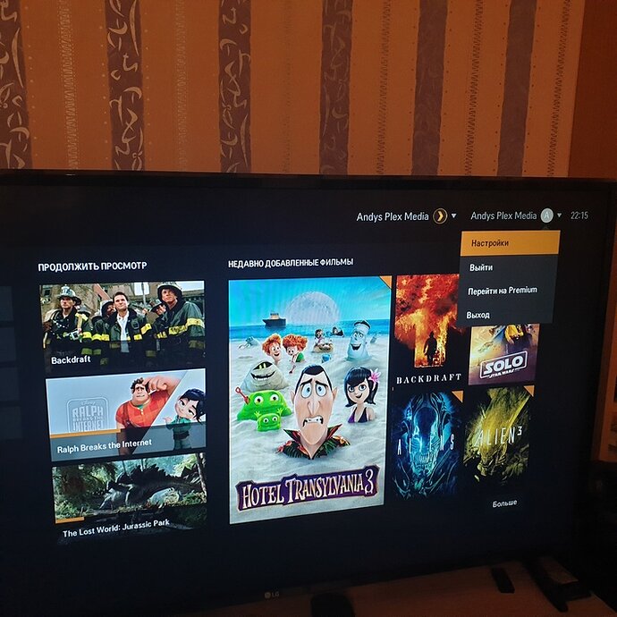

I have been experiencing a stange issue with the web os version of the plex app.
when i go into the app the headings above the section appear in different languages, after watching a film they tend to revert back after a bit, but this keeps happening, any ideas.

Those text are based on the language set on your TV. Check your settings and make sure you are in the correct location.
