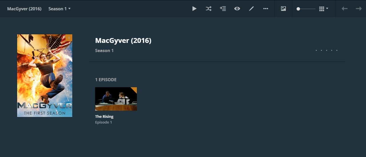

EG:
Macgyver … The original aired in 1985 but we do not use that in the title.
Macgyver (2016) … The year is used to distinguish from the original series, if you omit the year, your files will match Macgyver.
Actually, the rolling nightmare that is the current Plex requires (1985) in the Title for the Original. Macgyver without the year will default to the newest version - and that’s not in the handbook. ‘Research’ was done, then quickly crated up and sent to that warehouse with The Ark of the Covenant:

It’s still all messed up as far as I can tell. I used @trumpy81 's show MacGyver (I had never matched either previously) without the (1985) in the hopes that it would match to the old one - as it should - but:
F:\MCEB-TV
…MacGyver
…Season 01
…MacGyver - S01E01.mp4
Resulted in an instant, fully populated:
Now, that’s how FileBot is going to name it because when FileBot asks the user to pick the right show, the user, wanting the old MacGyver is going to pick simply MacGyver and FileBot is going to do what it does so well and match the name to TVDB just like it should. At that point Plex Horks up a bucket of dragon snot and matches it to the New MacGyver (2016).
The bewildered user, not knowing anything about Plex’s mystery naming scheme comes to the forum or uses ‘Fix Match’ then wonders why they spent that 20 bucks on FileBot that used to be The Miracle Worker when naming files and developing structures for use in Plex.
