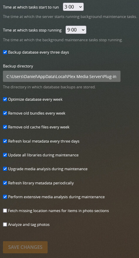

I’m trying to figure out the best time for Windows and Plex to auto-update themselves so they don’t take any Plex streams down when someone’s likely to be connected to the server.
How do you specify the time frame when PMS updates itself? Does this happen within the Scheduled Tasks start and stop times?
I believe so, but I did not find any confirmation in the support docs.
https://support.plex.tv/articles/202197488-scheduled-server-maintenance/

I guess this is the answer:
My problem is there’s no mention of version updates being a “task”.
Should we assume that it is a task, albeit one that isn’t actually mentioned anywhere under Scheduled Tasks?!
IMO there should at least be an additional entry that says “Install version updates” and then have its checkbox checked but grayed out, to indicate to the user that they can’t disable it from happening within the maintenance window.

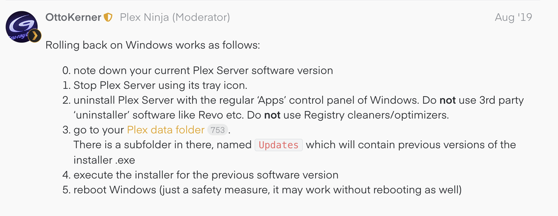

Just in case it’s good to have this information for a rapid roll Back.
Thanks to Otto
THAT is a good idea.
