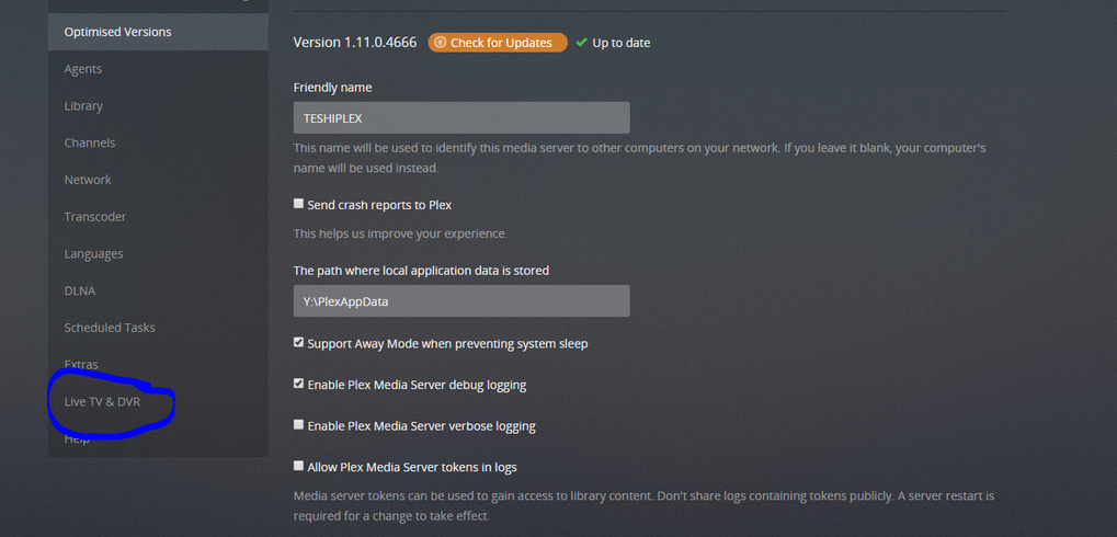

In your server settings Http://qnapip:32400/web > settings > server do you see the circled option below
Hello Teshiburu, thank you for the reply.
No I do not have Live TV & DVR in the menu on the left hand side.
Thoughts?
Kind Regards,
Simon
Try signing out and signing back in to your sever. It may not be picking up that you paid for your Plex Pass.
Make sure you are not running an old Plex Media Server version. Current version is 1.11.0.

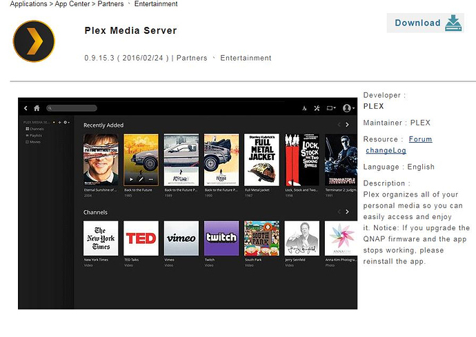

That is pre DVR.
This is the version listed on QNAPs website
Simon
So thank you guys so far… are you saying that I need to sign out of the Plex on my NAS when I can next do that?
I don’t see a newer version of the App.
Simon
Plex.tv/downloads has the current version.

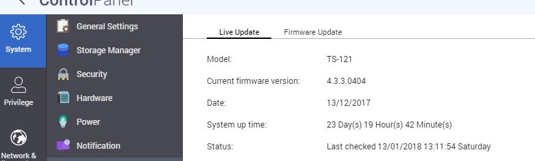

Fellow Users - I have tried to download the later version of the QNAP App from the Plex site.
I am running the most up to date operating system on the QNAP 4.3.3.0404 on a TS-121 but NONE of the packages on the Plex site will install.
Is there some kind of minimum spec for the QNAP? I can’t find any info and have paid for my Plex Pass but can’t use it :frowning:
I don’t have a QNAP but found this forum post that mentions using the AppCenter: https://forums.plex.tv/discussion/208401/install-update
Thats an arm cpu i believe. you need to confirm that they have a version for your cpu that supports live tv. when i goto downloads i see arm v7 x31 which i dont think is what you need.
