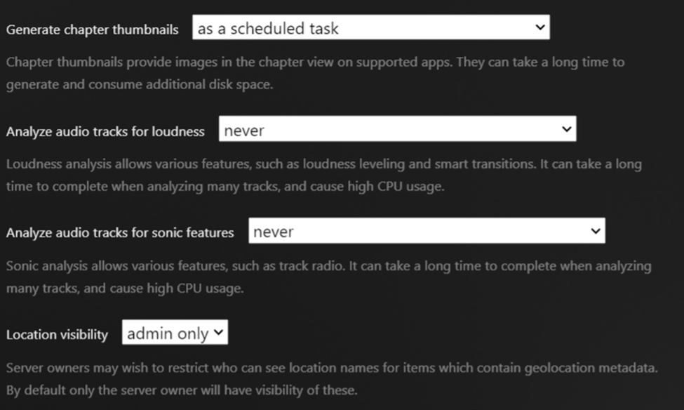

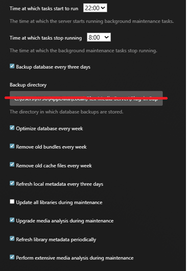

I noticed that at some point recently, Plex have changed the scheduled tasks settings layout, wondering if maybe this could be my problem as I have never had automatic library scanning enabled to stop disks spinning up and down randomly ( I have a 12 drive array on my Dell R730 and a 4 drive array on my ReadyNAS RN214). I’ve no idea how Plex handles chapters, I always just assumed if your client was using DirectPlay it would read them direct from the MKV, perhaps this is not the case and the chapter markers are still presented by PMS to the client. If this is the case, I wonder if my chapters are not being analysed by Plex when I manually refresh the library after I add new files like they did before this changed. I’ll post pictures of my settings below, perhaps yours are similar? Just to make this clearer, when I copy new MKVs, typically source ripped BD/ UHD, onto the server, I have to manually “update all library files” for them to be processed. I’ve setup Plex not to automatically look for new files as my NAS would spin up and spin down all the time.
I’ll take a look a bit later on (phone images are too hard to compare), I know I’ve tried changing these settings a bunch of times. When I first came across this I blamed this on a set of files I have recorded off TCM via CableTV using my then-operative HD Homerun and added to my main library. That led me to pulling all those files and putting them into their own library; that apparently wasn’t the (only) cause.
I’m not seeing anything jumping out of me as there are several differences in the setups (not that I really spent time analyzing my selections)
