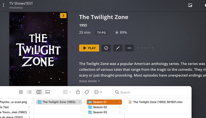

Hi all. I don’t see where in TVDB I can find the show name that Plex needs to see to recognize a show. For example, I just uploaded the original Twilight Zone. I found through online searching that the show names needs to be “The Twilight Zone (1959)” but I don’t see that anywhere on TVDB. Now I’m trying to upload the original “The Brady Bunch” but Plex isn’t recognizing it. I assume it needs the right date after the show name but I can’t find this anywhere in TVDB.

unless it is explicitly in the name use the start date of the show. unfortunately afaict TVDB does not add it as a separate field these days and instead uses the date of the earliest episode.
In the case of the Twilight Zone The Twilight Zone - TheTVDB.com the S01E01 was in 1959 but they have a special from 1955. so you would use The Twilight Zone (1955)

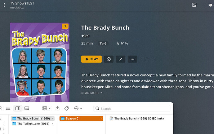

Thanks folks. That works for the original Twilight Zone but applying that same method to the original “The Brady Bunch” I would think I would use “The Brady Bunch (1969)” but Plex doesn’t recognize it.
https://thetvdb.com/search?query=brady+bunch

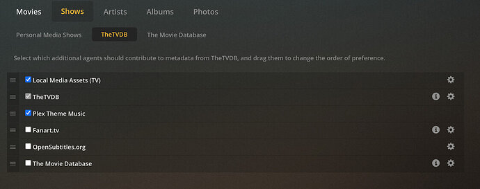

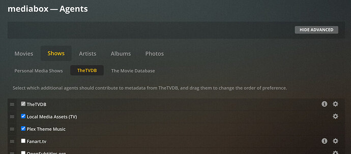

How exactly is the TVDB set up in the server agent settings? It seems to work fine for me. If you are using mp4s and local media is at top then they could have bad embedded metadata that is making things wrong
I seem to have it set up that way. I’m using .mkv files.
does it list it as an option if you do a fix match?
So, when I did a “match” with TVDB is resulted in “no match”. When I switched it to moviedatabase it did work. Is it ok to switch databases? Can I use any database I want for any show?
a new show will always use default database but yes you can fix match with a different one.
