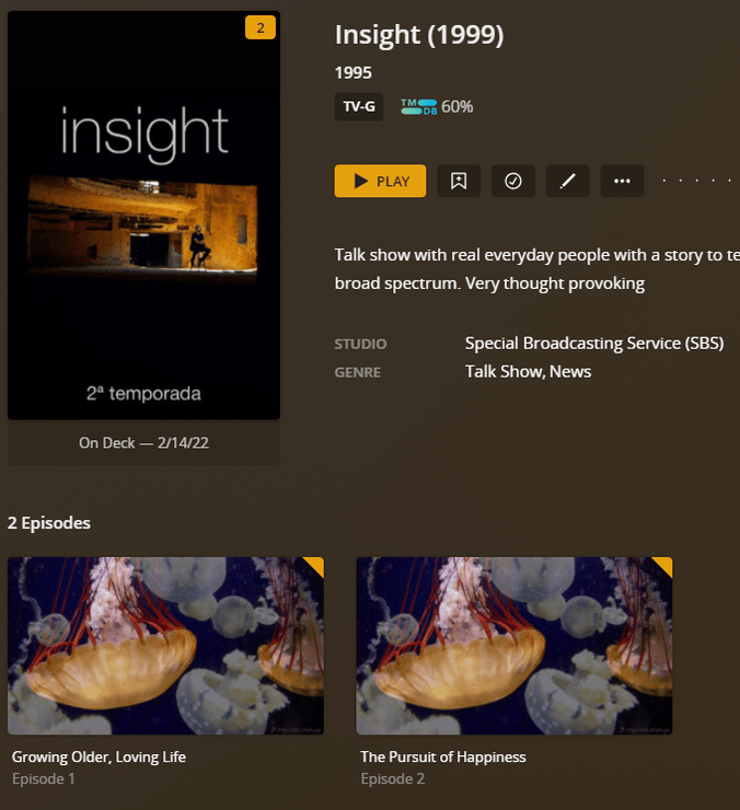

You want to match this show:
Look at the episode names. They match for season 2022.
It is very possible that thetvdb or themoviedb.org have incorrect info. That is not uncommon.
TheTVDB will correct things, but we have to tell them what to correct.
Thank you for trying to help with my problem. But the show you have found in your result is not the correct show. I have provided a link to the correct show in my original post. If you go to that link you will see that it is a different one to the one your filenaming found. I also listed the one you found in my list of incorrect links.
I also mentioned in my post that I am the person that maintains the series on TVDB. I know my naming matches because I keep it up to date every week. theTVDB has correct info, under the correct show page.
I see what you mean with the episode titles but the graphic you have indicates to me that you’ve matched with the wrong one. Check out this link:
https://thetvdb.com/series/insight-2019
If you look at the graphics on the correct one, the poster you have is not there.
https://thetvdb.com/series/insight-1999
Edited to add - this crossover of data from the two pages indicates to me that there is some kind of indexing problem.
This is what it should look like:
Yes. Plex is mixing shows.
It looks like it is also picking up information from this entry:
Insight (TV Series 1995- ) — The Movie Database (TMDB), which looks like it has bad information - the cover art from Insight (2019) in Portuguese but identifies it as broadcast in Australia (SBS network).
I do not see an entry in themoviedb for Insight (1999), the show you want.

Looks like case where the MovieDB is confused.
This show I think was supposed to be the AU version as it has the correct show data but the the poster and backdrop are incorrect: Insight (TV Series) — The Movie Database (TMDB)
Contributors seem to be confusing it with this show: Insight (2019) - TheTVDB.com
Somebody needs to fix the TMDB entry.
This new entry is a duplicate and should be removed: Insight (AU) (TV Series) — The Movie Database (TMDB)
To help I have fixed the show level external ids for both IMDB and TVDB. These linked to the wrong shows so it should help with things once the change is replicated into the plex back-end system. Give it 24/48 hours.
BTW… I’m not familiar enough with the show to add the missing or fix up other incorrect content, maybe someone who is here would do that.
I’ve reported the content issues to TMDB as well as the duplicate TMDB entry.
I’ve also reverted the TVDB link to the TMDB page as it was correct.
Those are now incorrect.
This is the correct show, it just has the incorrect posters (see my post above yours).
This is the AU show: Insight (TV Series) — The Movie Database (TMDB) / Insight (1999) - TheTVDB.com
This is a Portuguese show: Insight (2019) - TheTVDB.com
Oh, let me revert back. Sorry, need my first coffee :frowning:
