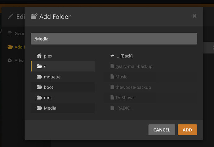

Thanks for your response. Here is a screenshot of what it does when I try to add media.
In this pic it shows the / for some reason but when I click on /Media it’s exactly the same files.

It looks like your permissions are not properly set (despite your OP).
Are those media folders (/Music/, /TV Shows …) mounted from an external drive?
You might want to review how you mounted them to verify the plex user can really see/access them.

May I be of assistance here?
I will jump ahead with the CliffsNotes:
ASSUMING this an ext4 or xfs filesystem
  1. Unmount the drive
  2. sudo chmod 755 /Media (base permissions must allow traversal)
  3. Mount the drive
  4. sudo find /Media -type d -exec chmod 755 {} \;
  5. sudo find /Media -type f -exec chod 644 {} \;
IF NTFS
  3. Mount the drive
Hi Chuck,
Thanks very much for your reply. I had almost given up on it :wink: But anyhow, the box ‘wandered off’ so I’m going to have start from scratch. No clue what happened to it.
I’ll give those commands a try, although I have already made plex:plex the owner of everything but perhaps the other ones with help.
Thanks very much,
Steve
