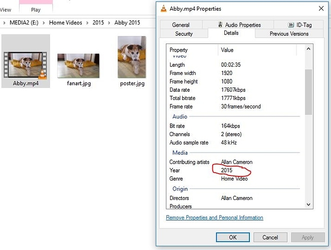

I have thought of that myself. I have tried my files with and without metadata and it makes no difference. Even files I have the embedded metadata year clearly label 2015 will change to a year that makes no sense. What I can’t figure out is my folder structure is very clear to the server. All videos is in a folder representing its year. I’m totally at a loss with this.

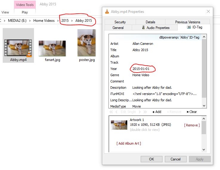

Here is proof of my issues,
All dates are correct with the files and the server.

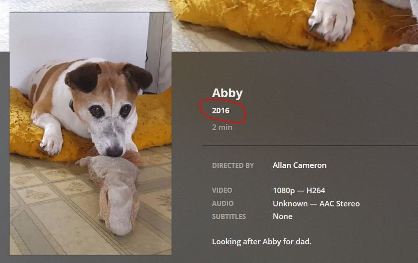

But as you can see here none of that matters… showing 2016.
Locking it after correcting it also makes no difference.
I can spend an hour correcting dates and soon after its all back to being wrong.
Note: even video without any metadata it still does the same thing.
Some dates are so far off it’s ridiculous. Video footage from 2014 displaying as 1970.

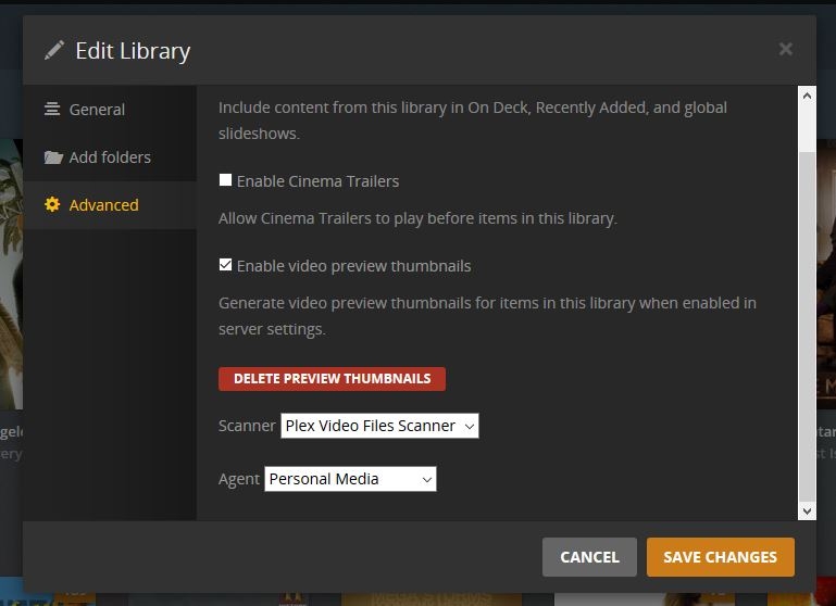

The library where you put those videos in, should use ‘Personal Media’ as its primary agent.
The verify this, edit the library, go to the ‘Advanced’ tab.
