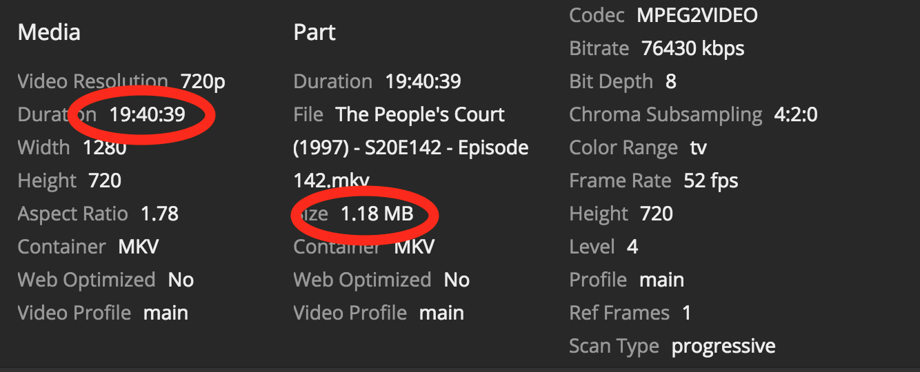

  • Every once in a while I end up with recordings that are hours long.
  • I’m guessing the second item there is causing the 3rd problem (as a tuner is “sucked up”), which is scheduled recordings don’t even attempt.
And obviously the file sizes make no sense. I attempted both on Windows and Linux with the current (at least as of yesterday), PlexPass version

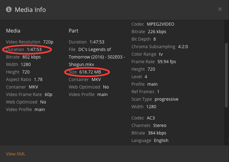

I set it up to record an hour-long TV show last night and it recorded about 11 mins and then the rest of the file seems corrupted. Also, Plex and VLC report that the run time of the file is 1 hour 38 mins, which is way off. The video quality is atrocious when I play it back through Plex, but when I open the .mkv file in VLC it looks amazing. Still cuts after about 11 minutes. Sound cuts out around 9 minutes.
I’ve tried experimenting with optimizing different versions but playback through Plex (and VLC) of the optimized versions look just as bad.
I didn’t have verbose logging on until now, so I’ll try to record another show and post back with the logs. The recording said it was successful in Plex and gave no indication that there had been a problem or abort or transcode error.
