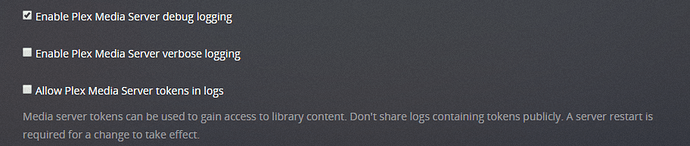

For any of these issues the first step would be seeing logs that cover the time when the recording would have occurred. Go to Settings/Server the following settings are correctly set:
Enable Plex Media Server debug logging - Enabled
Enable Plex Media Server verbose logging - Disabled
Allow Plex Media Server tokens in logs - Disabled
The next time this occurs you would need to grab logs and post them here. To grab the logs go to Settings/Server/Help, click the Download Logs link and upload the zip file created.
