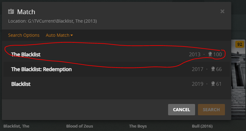

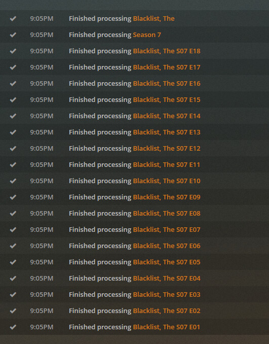

I have a lot of TV shows - I started the scan about 9 hours ago - it only got about 1/5th and nothing new was updated in the past 4 hours. I tried to click on match and it couldn’t find any TV shows of that name so I switched my source from the TVDB to the movie database agent - it matched a lot more TV shows. However it doesn’t seem to be updating them either.
I’ve tried unmatching the show and fixing the match and selecting the right show with the year of the first episode.

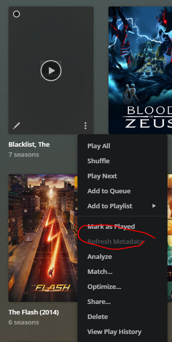

I see refresh metadata is greyed out sometimes - is that because it is doing something in the background?

Even if I restart and force the refresh the icons and data remain blank -

TheTVDB is making a lot of changes on their end, which results in matching problems on our end. If something does not match, try a Fix Match with the TV series ID as listed at TheTVDB (266189 for The Blacklist). Leave the year blank. It should match straight away.

Thanks - you are correct, it was the agent - switched it for a number that the TVDB couldn’t find and I’m down to my last show that is unidentified.
