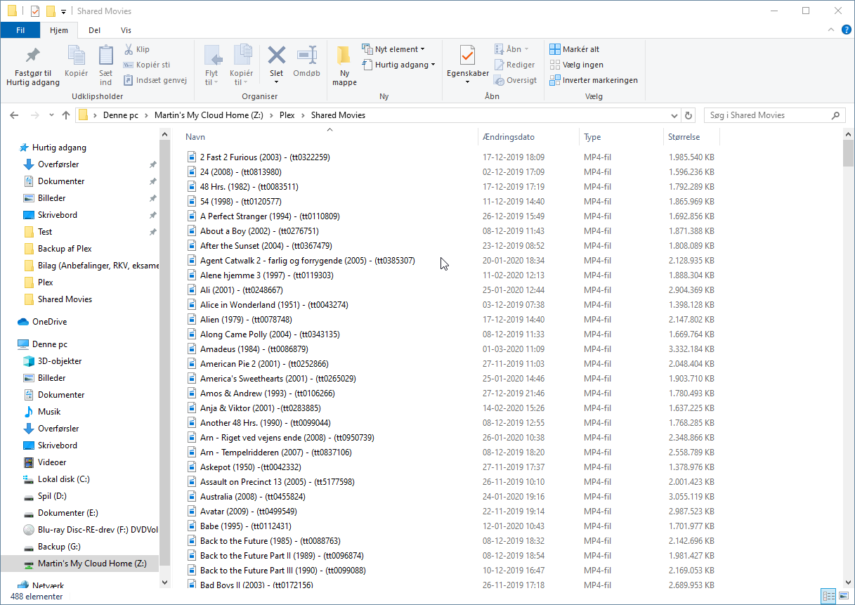

Suddenly after i updated 2 days agi, i can not match new movies i am putting into my server, not even when i try to do it manually, have tried to update all metadata??
Im naming like this “Amadeus (1984) - (tt0086879)”

It is Mp4 and mkv files. I do not have any images or subtitles(burned in).

What are you meaning with Movie libary??
Im using these 3
