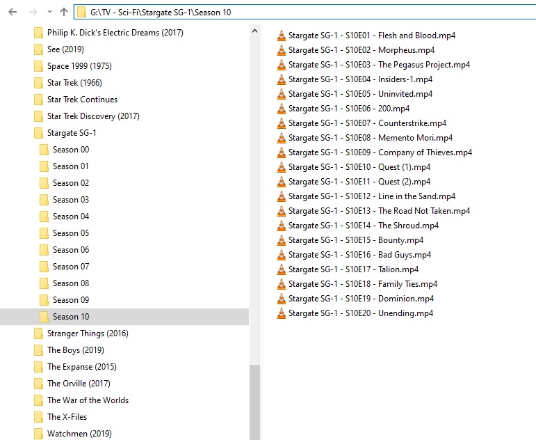

The day I started using FileBot was the day Stargate SG-1 started misbehaving badly - not surprising as I had the biggest non-compliant naming horror show known to man:
FileBot fixed that mess (all 235 episodes) in UNDER 1 (one) second. Now NOTHING is added without first going through FileBot.
You will still experience the odd mis-match (Plex normally fumbles about 10%), but it won’t be because your naming is wrong.
