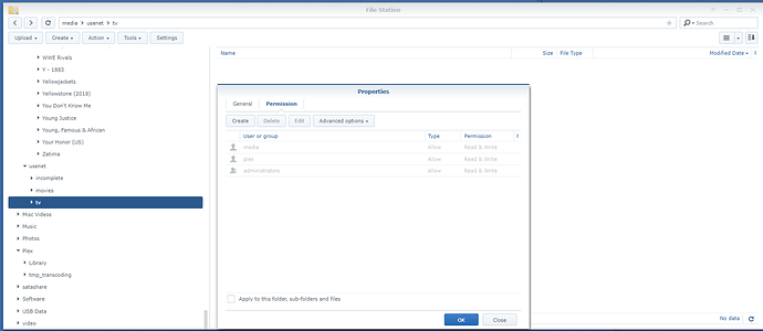

Here is where it gets weird, permissions seem to change at the file level for x265, where all other files are fine.
Example
Outlander shows the correct permission at the root folder level.
Outlander.S06E01.1080p.WEBRip.x265-RARBG Permission changed (Plex cannot pick up)
Outlander.S06E02.1080p.WEBRip.x265-RARBG Permission changed Plex cannot pick up)
Both x265 files have the admin accounts but is missing “everyone”
   Outlander.S06E03.720p.WEB.h264-KOGi (Plex can pick up)
Here are the permission on that file
So I tested and added “Everyone” to the route Tv folder and applied to all folder and re downloaded the same file.
Everyone is missing for the x265 at the file level causing plex not to the see the file.
When and copy the entire show directory to “Misc Videos”
The permission stay in place and plex is able to see the x265 file
When I copy the directory back to the main TV folder Plex can see it.

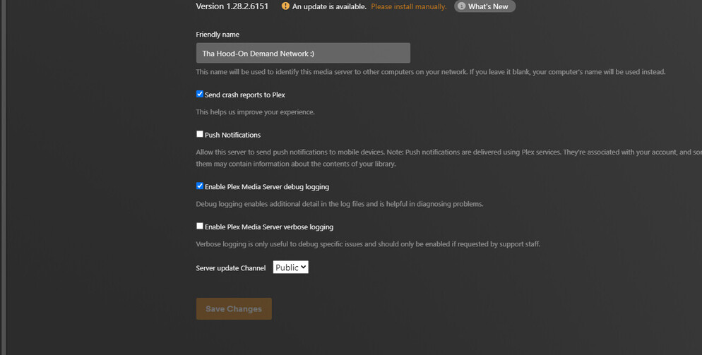

Please verify DEBUG logging is enabled again (if you disabled it)
Recreate the problem as best you can
Download the server logs (settings - server - troubleshooting - download logs)
Attach the ZIP file it presents you
Its something HEVC files, plex can’t see them in the Tv directory. All other formats work fine.
Debugging was already checked off

Recommend giving a force (re)setting of permissions via FileStation - Properties - Apply to this folder, sub-folders, and files.
If that doesn’t clear it up after dancing the files, we’ll dance to HEVC codec
I did a reset or permission on folders, before I posted here and I got the same results. The permission break some how.
