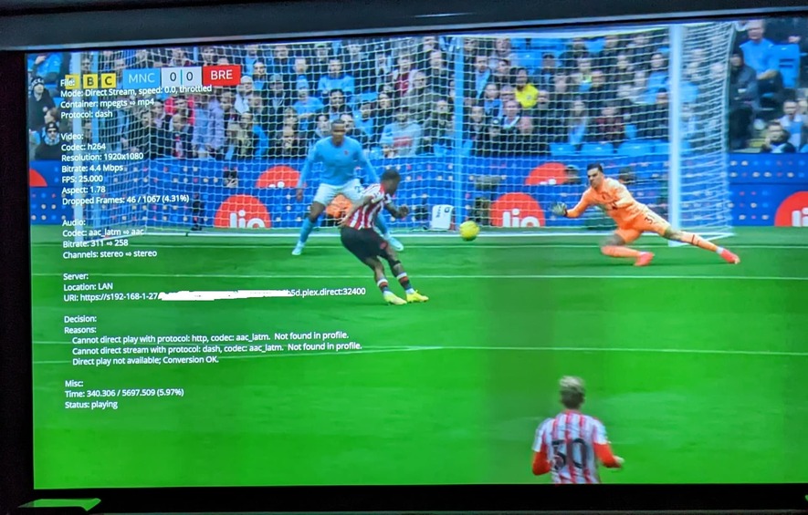

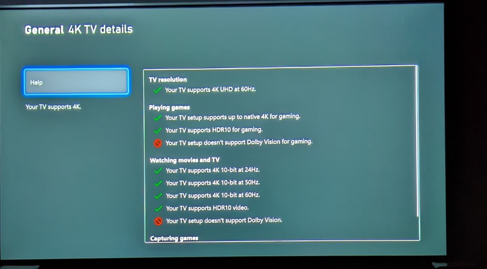

In the UK we watch TV at 50Hz, my Xbox is set to allow 50Hz playback with my projector.
This is a recent regression, but basically whenever I play back DVR recorded TV (1080p/i @ 50Hz) it continually now stutters - bringing up advanced playback information shows it is frame dropping.
I ran an Xbox network test, and it shows no issues.
I can playback 4K HDR @ 24Hz no issues, no frame dropping - if it can cope with this much higher bitrate then 1080P should not be an issue.
This is a 50Hz problem only, if I disable 50Hz in Xbox then it plays the same content at 60Hz fine.
