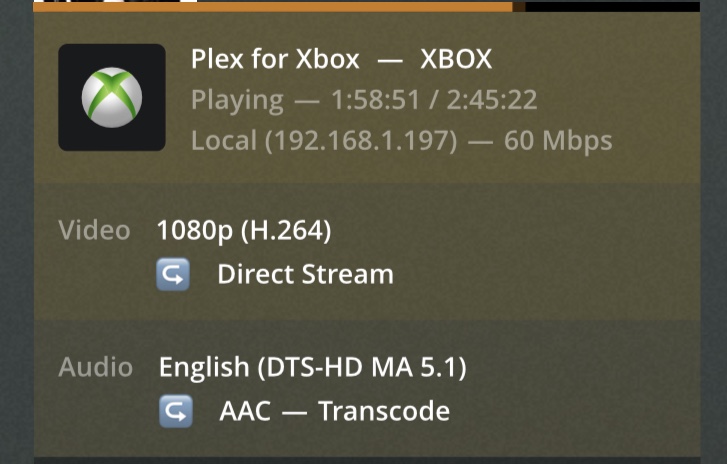

I checked and it is playing local. It shows the video direct streaming but the audio is being transcoded from dts-hd ma 5.1 to aac. It does this for every 1080p mkv I throw at it.
This normal, Xbox has limited audio support and no pass through.
That’s fine I have no problem with it transcoding the audio, my main problem though is that everything it transcoded gives me green artifacts and the video plays with constant freezes and artifacts. This never happened on my Xbox one, only the Xbox series x that I just got.
For my server I am using the Nvidia shield pro 2019 model on a wired gigabit local network. It doesn’t give me the green artifacts on my phone, pc, or tv Plex app.
That’s weird, the image above shows only the audio transcoding, so the video should be unchanged.
Direct stream is only remuxing into a different container.
