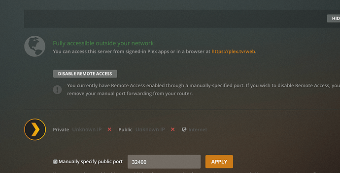

I’ve spent hours trying every possible combination…I now have a message that says my server is available outside of my network…although from what I can see, the settings are the same as they were previously!!

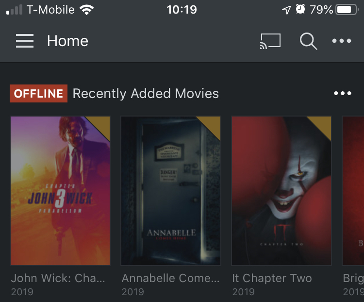

but, all I get from an external device is this which says the server is ‘offline’
