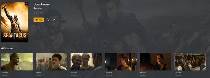

Up until last week the show Spartacus and its special season Gods of the Arena was picked up correctly by plex using tmdb episode ordering matching all metadata, titles, summaries, rating, cast etc… as per tmdb.
However, this week after a metadata refresh all the episodes for this season are now unmatched by plex with all the data removed . Unmatching also changes the guid to a local id which also now means any watch history or view state for the episode is also gone! Grrrr…

I assume that this Special was watched previously and the screenshot of the Special above is the proof that watch history/state was removed. Without another metadata source change it’ll be difficult to reproduce this. Regardless I’ve at least raised this with the server folks.

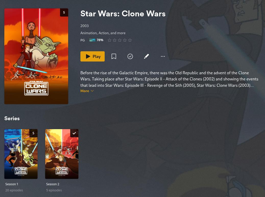

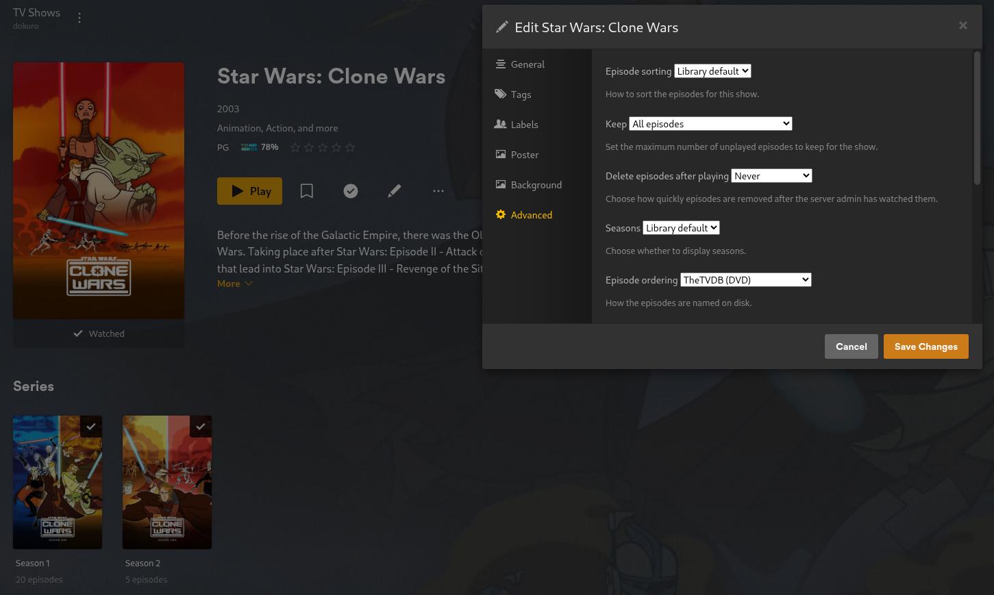

Okay, so I’ve been able to force this change. Lets take this show Star Wars: Clone Wars (TV Series 2003-2005) — The Movie Database (TMDB) and I’ve named my files match tvdb (dvd) ordering, all episodes are watched and have played history …
Now, lets simulate a change by changing the episode ordering in plex to The Movie Database (Aired), which is a significantly different ordering than the DVD order. I have not renamed the files, only changed the order in plex. Force refresh the show at this point. The watch history etc… all remain. No problems so far however episodes 1x11 → 1x20 are unmatched.
Now, revert the change and set it back to TheTVDB (DVD). Force refresh again and boom, 5 episodes have switched from watched to unwatched.
These are episodes 1x11 - 1x16.

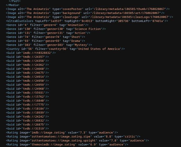

BTW… for giggles take a look at The Animatrix (2003) — The Movie Database (TMDB) and the xml on your plex back-end and you will see the following …
Every time I check for new dups this makes me laugh!
The removal of watch history/state seemed like the more important issue initially. So returning to the “root” of the issue in the OP, I’ll split this out into it’s own issue for guidance. Can I assume the “solution” would be to allow for locking a title down to no longer receive changes? Or was there something else you had in mind? Just trying to gauge expectations.
Man… what did they do to The Animatrix… So it’s a Show but also a Movie with 9 Movies in it… :see_no_evil_monkey:
