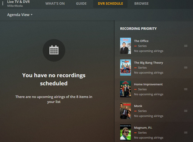

You have no recordings scheduled But

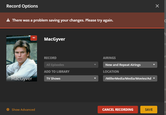

The issue is, I have scheduled shows to be recorded and get this error.
In the logs I am getting this Error
30273: Nov 04, 2020 08:32:22.563 [0x7f8b84ffd700] ERROR - SQLITE3:(nil), 1, no such column: blob_type in "select `blob` from blobs where linked_type='media_subscription' and linked_id=31 and blob_type=4"
However, it still shows on the guide as scheduled for recording
But on the scheduled recording page does not show any listings
Then when time comes to record, the system does not record.

If deleting and recreating the recording doesn’t resolve it I would see if you have other SQLITE messages in your ‘Plex Media Server.log’ , could be a slightly corrupt DB.
If you removed and added the TV Shows library then you need to reselect the “add to library” on each recording, the name may be the same but the id is different and the recordings will fail.
Thanks @pl_5309,
I went back to check the logs again and could see a permissions issue. I went ahead and reset the user:groups, plex:plex and it all works again.
