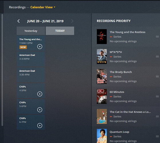

I just noticed my recordings were showing no upcoming airings as well.
I deleted my hdhr dvr in plex, then re-added it.
the recordings still did not show any airings

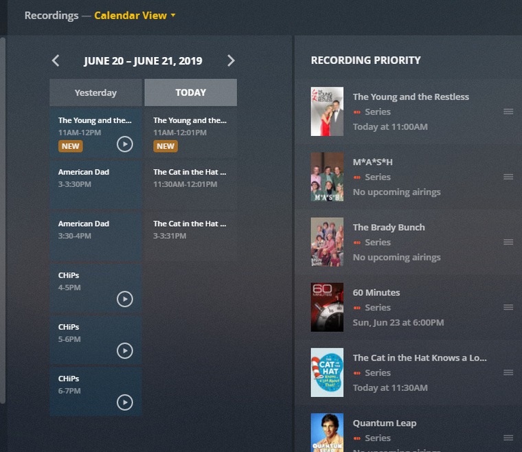

I went through each show and clicked ‘save’, then the recording updated to the new airings, notice the different show pictures
