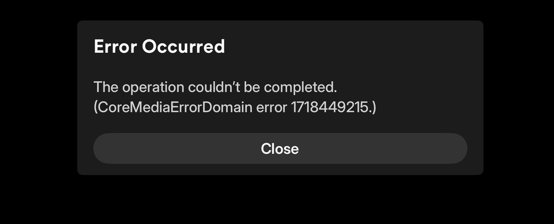

2025.15.0 (1053) iOS roll out broken live tv playback for anyone else?
So resetting the cache will make some videos work for a bit, but then some just won’t load, and eventually trying to load any will give me the error above.
The exceptions being some IPTV channels I pipe into TVHeadend which consistently work…… the OTA channels served to plex by TVHeadend are the ones that are having the issue. I think if I transcode them on TVHeadend they’ll work reliably, but I haven’t worked out a TVHeadend profile which works with plex yet
I’ve come to the conclusion that it’s an audio codec issue. I’ve I disable “Allow Direct Stream” I get no audio but video plays fine in every stream. If I have it enabled I get audio on some of the streams (the ones I’ve mentioned work fine) and the errors on the ones I’ve been having issues with.
So I’m going to look at using TVHeadend to pas through the video codec and reencode the audio stream…… but that’s a tomorrow job.
Disabling "Allow direct stream and/or “Allow direct play” makes no difference to me.
I played around a lot, including reencoding streams to AAC and nothing worked. I don’t know if it’s to do with the use of ADST on my streams.
Basically plex needs to sort this one out.
Still broken on v17 with CoreMediaErrorDomain Code 1718449215 error.

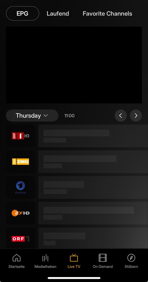

Since big iOS update, guide entries are completely blank. When streaming a station, black screen (but audio works)
Web client works fine, VLC works fine.

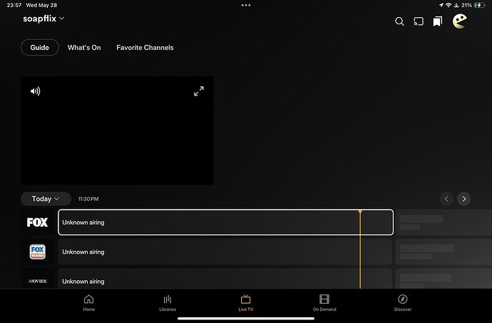

2025.18.0 (1109) fixes live ota tv playback but the guide for my hdhomerun channels still show as “unknown airing” on the iOS app. Web has a perfectly working guide.
