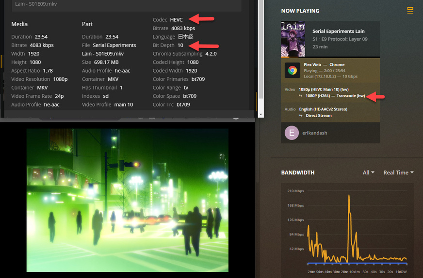

@RockStar - for what it’s worth, I can anecdotally confirm what @FordGuy61 said, that the 10th gen cpu in NUCi7FNH is capable of transcoding HEVC 10-bit out of the box, here’s a bit of proof:
So, feel free to move forward with whatever you were planning!
I realize the chip is capable, but Plex transcodes to 8 bit AVC and doesnt support tonemapping. So the chips capabilities doesnt really help until plex decides to either implement mapping or choose to retain the 10 bit colors / transcode to hvec
