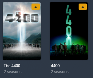

Nevermind, I think something bugged after I updated my NAS yesterday. I rebooted it and now the agents work fine. I can see both versions of 4400 without issues.

The Plex Dance worked, removed them, did all that stuff and rescanned now I have both shows listed in my directory. Thanks for all your help!
