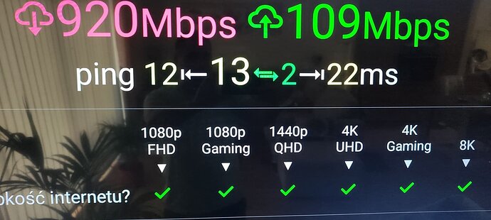

Thanks for reply not sure how long. 90% files its not bigger than 50gb and bitrate less than 30mb/s only I have problem when I try play video with 40-60 mb/s bitrate everything else working fine. I did speed test on my nvidia shield its 900mb/s so I think cable and connection not makes any problems

And this is really a speed test, between Shield and Synology?
To me it looks more like this is just the up and download from fiber optic or cable internet.
There must be a blockage in the line somewhere, because the symptoms indicate that the gigabit line is being throttled to 100Mbit and therefore only the films with a low Mbit can actually go through without jerking.
