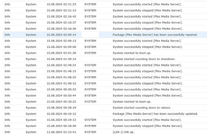

After updating my Plex Media Server to Version 1.40.5.8854-7000 he always stops running after 15-20 minutes. This happens even if I don’t play anything.
The synology log only says that pms was stopped successfully.
The last PMS version (and all before that) ran without problems. The problem only occurred since I updated to version 1.40.5.8854-7000 about 3 hours ago.
I have already restarted the Synology and reinstalled the PMS update but that doesn’t help. Every time I start the PMS he shuts down again after a short time.

If you mean the log files from my NAS, there is hardly anything in them, just that the Plex Media Server was repeatedly stopped by the user “System” (see image in the attachment).
